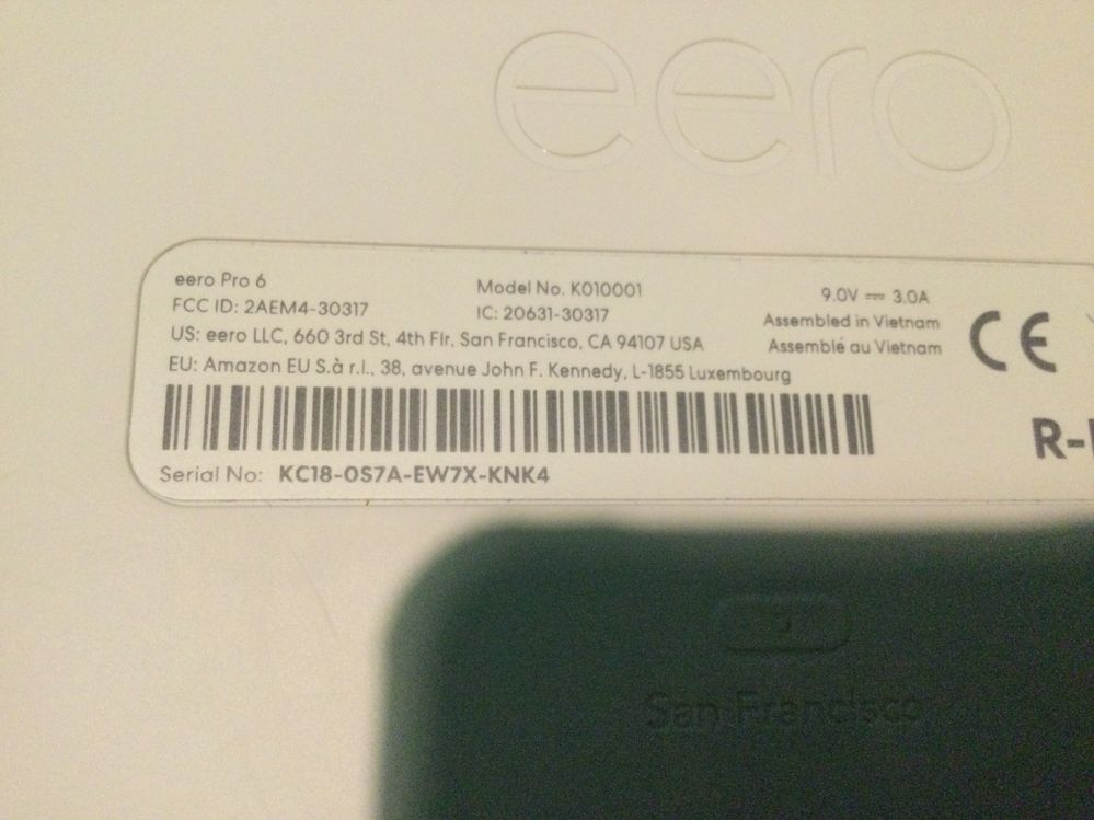

Will not connect via eero app, cannot be found. When asked for bar code cannot be found after scanning it. App asking to try a different placement. It literally is next to base unit. Tried wirelessly and connected to Ethernet port on base unit. In eero app says nothing is connected to that port. Tried hard resetting with button underneath at least 30 times for a minimum of 15 seconds  plugged in and not plugged in. Tried power cycling new eero and base unit.

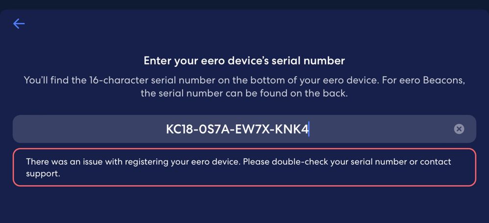

When tried as a new gateway device with a new network I received this message after inputting serial number “There was an issue with registering your eero device. Please double-check your serial number or contact support”.

Yes, tried every configuration possible I believe. It just will not be found or leave the state of “flashing white light”. Regarding hard reset, tried again last night with it pressed in for at least an hour (by taping something in place and a weight on top). Nothing. Tried connecting it to another eero wirelessly and wired. Nothing. If you see my previous notes when it was attempted as setting up as a gateway the message after entering serial was “There was an issue registering your eero device. Please double check your serial (barcode was scanned) or contact support”. Is it registered somewhere else perhaps? And blocked?
