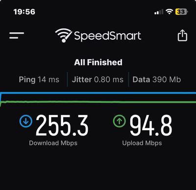

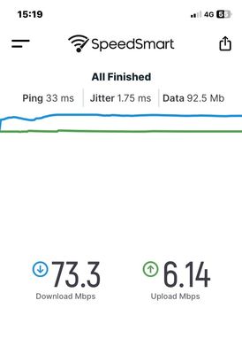

moved to a new house and got upgraded to talktalk full fibre 900 via eero router
when I moved in I did a speed test via my phone and I was getting 800mbps speed
as you can see from the two below screenshots stupid question
im now getting way below that on wifi

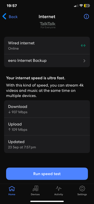

the eero router speed test shows the speed I’m paying for
am i being stupid or am I missing something, why isn’t the wifi speed the same same speed as eero router? It’s like the wifi speed is capped to 300’ish

ok I’ve checked my settings
my mobile phone is an iPhone 11
It is running on 5ghz wifi when doing a speed test my mobile is right next to the eero box
Client steering and dns caching are ON in eero settings
I just updated the eero box and miraculously my speeds have increased (see screen shot 1 546mbps download)
Also ran a test on my mini pc (9 year old acer mini one sat next to the eero box ) download 47.39!!?😂)
also my work iPad 7th Gen I got 415mbps download
I guess there’s two things to note
1- depending  how the eero box is feeling depends on the speeds it gives out ool
2- it’s mainly down to the actual device that’s being used and the wifi card installed
Thanks again
