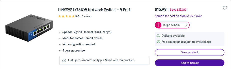

Thank you. I think I'll buy this. Still can't speak to Talk Talk on the phone. Promised me a lot but not delivered.

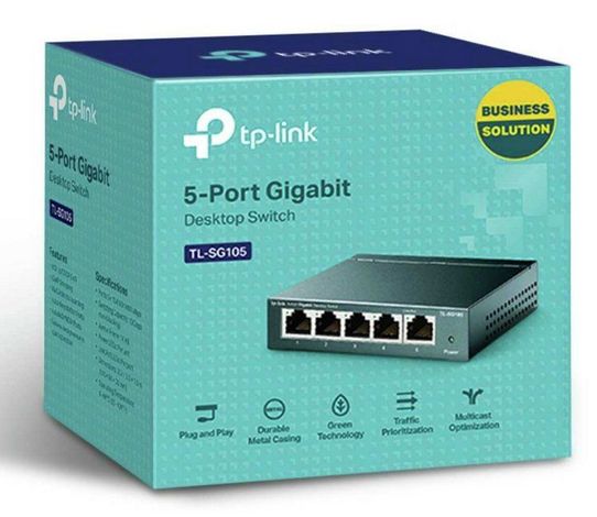

@Diljit wrote:
Thanks. I had 4 ethernet ports on the old router. Is the  Linksys LGS105 switch as shown above compatible with the erro.
Ethernet switches  all do the same job (see diagram below) the one below definitely has been discussed in the forum before -
Buy TP-Link 5 Port Gigabit Ethernet Switch | Network switches | Argos
About this product
With 5 10/100/1000 Mbps ports, TL-SG105 expands your network capacity, enabling instant large files transferring.
The TL-SG105 can automatically detect the link status of each port and reduce the power consumption of idle ports.
Designed to save up to 65 percent of power consumption.
The TL-SG105 also can analyzes the length of the Ethernet cable connected and adjusts the power usage accordingly.
