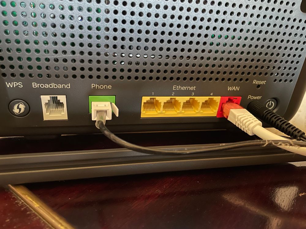

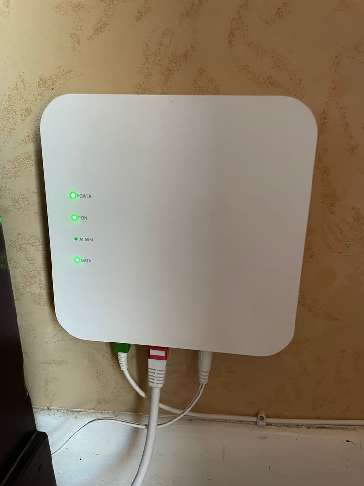

I have spent over 4-Hours on Live Chat with TalkTalk 'experts' trying to sort a problem that i'm sure is very simple to rectify but I just get passed from department to department, person to person, repeating the same discussion. Hopefully, someone can help, TalkTalk seem incapable!
I've been waiting since December 30th for a reply back which was promised, but also they have failed to do.
We had the full Fibre service upgrade which was completed on the 30th December with new fibre cable into the house connected to a new ONT box & a new Router. The 3-green Neon indicators on the ONT box are all illuminated  so I understand the connection is all good. The Router still has a solid Orange illuminated indicator on the front which indicates no broadband connection. We have tried the 20-minute power off then switch back on routine several times but to no avail. The router is connected to the ONS Box with the ethernet cable supplied &  photos  of both, with the cable connections were given to the live chat people when requested.

That looks fine, thank you. Normally, a flashing orange light indicates that there is no connection to the fibre. From this, I would suspect that the router is probably connected, but not authenticated with the TalkTalk network. The ONT must be fully registered with the TalkTalk network, which should have been done by your go-live date. When the router originally tried to authenticate, the light sequence would change from orange to flashing white/orange. When this process failed, it goes back to just flashing orange.
Before saying that you need to go back to the Full Fibre helpdesk (yes, I realise this has problems for you & that the time is taking), there is one thing you can try.
Disconnect the Ethernet cable at both the ONT & WiFi Hub and then reconnect it. This is just in case one connector is not fully seated correctly in the sockets on either the ONT or the hub.
If this does not sort it, please let me know, as I might be able to get a contact of mine at TalkTalk to intervene for you.

Hi Keith, thanks for your help.
1: The Full Fibre Installation was completed by City fibre.
2: The ONT box has 3-green Illuminated indicators. These are Power, PON & Data. The Data doesn't 'Blink'
It also has another indicator labeled as Fault. This is not illuminated
3: We had a Sagemcomrouter model FAST 5464-2.
4: The ethernet cable from the ONT box does connect into the red Wan Socket on the router

I may be able to help you, as requested by @mandisa1-TT. However, I will need to know a few answers to these questions first. I appreciate that you will be repeating this information that you have previously given to TalkTalk, but as I am a customer myself, I have no access to that.
Please can you confirm:-
  1. Was the Full Fibre provided by Openreach, CityFibre or another company?
  2. The ONT varies between the different fibre installers. Please can you look at the ONT & tell me exactly which three lights are on?
  3. I assume that you were given the TalkTalk Wi-Fi Hub 3 and not the eero routers?
  4. The Ethernet connection between the ONT & Wi-Fi hub needs to terminate in the red WAN socket on the rear of the Hub 3. Is it connected like that?
