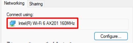

Could you please answer my questions, such as what version of Windows you are using & whether the drivers for your WiFi card are up to date? There has to be a reason

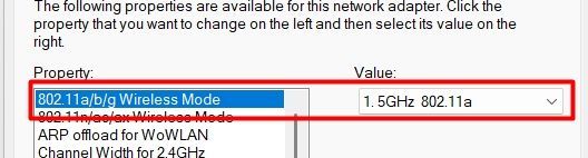

Using a wide channel of 160 MHz called channel bonding.

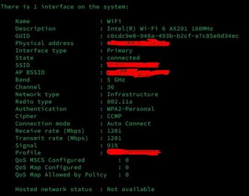

Hi @bitrate
I wonder if your problems are related to your PC or your Wi-Fi driver.
Your netsh output clearly shows that your Wi-Fi Mode(Radio Type) is set to 802.11a and your TX & RX Link rates are both 1201Mbps. The legacy standard of 802.11a only supports a maximum data rate of 54Mbps; how is it achieving a rate of 1201Mbps?
What version of Windows are you running & do you have the latest drivers installed for your AX201 Wi-Fi adapter from the Intel Downloads page?

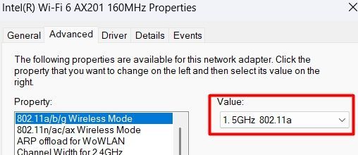

That is your choice, but if you want to stick with the oldest 5GHz WiFi mode, you'll never get any advantages from WiFi 6.
Why not reset your WiFi adapter properties and then investigate why you were connecting to the 2.4GHz band?

This is where we differ, and I would not go deep technically. But I will stick with 802.11a.
KeithFrench
Message 26 of 60
That is not the correct way to prevent connection to the 2.4GHz band. You are, as I said, using a very outdated WiFi mode, because of your configuration. Sure my way allows connection to both bands.
I have also said TalkTalk do not provide any WiFi 6E or 7 eero. That will not help you anyway, when you insist on using 802.21a, rather than 802.11ax (Wi-Fi 6).

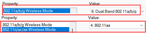

I have selected 802.11a because it supports only 5 GHz. I don't want to be connected on 2.4GHz at all.
802.11a802.11a
This option is also correct.
802.11ax802.11ax
What you've selected is not ideal, and it creates more latency due to 802.11b (max. 11Mbps). With this selection, the eero (Access Point) will broadcast B frames as well, creating more congestion in the air.
Trust me, I know what I'm talking about... I get paid to do this 🙂

The radio type you are using is ancient; it needs to be 802.11ax (Wi-Fi 6) when using an eero. You have misconfigured your Wi-Fi card. The default options would have been best; this is what it should be:-
Set 802.11axSet 802.11ax

This output I have with "netsh wlan show interface"
netshnetsh

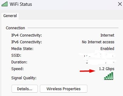

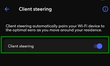

Thanks, mate, for all this information; it's very helpful!
I have a wireless adapter that is capable of Wi-Fi 6 at 1.2 Gbps.
- Client Steering is ON
- Local DNS caching is enabled
I've seen other providers have consistent speed more or less, but not like TALKTALK hitting 93, 114 etc on Fiber900.Adapter Status.jpgWireless Adapter Model.jpg

What do you get if you run:-

3) To aid with step 2, is "Client Steering" enabled within the eero app, as well as "Local DNS Caching"?
