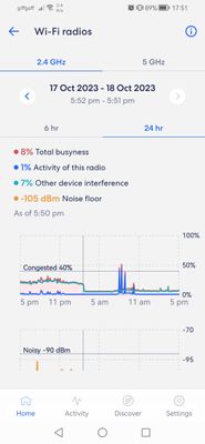

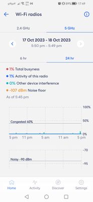

Looking at the Eero app, the 2.4GHz channel is going over the 40% congested mark once I'm using the laptop, but the 5GHz channel looks to be unused.

And have just checked with Netspot - my laptop is picking up several 5Ghz network signals set on channel 80, but not the channel 155 from my Eero.

Thanks Keith - just tried that, but 5G is still stuck on channel 155,even after turning the channel off & on again.

I'll look at your PM in a moment, because as of yet I didn't know what 5GHz channel you were on. However, as you say you are on channel 155, I would think this is exactly why you can't get a 5GHz signal, just like @jenny727.
The problem is that not all WiFi cards support that high range of channels within the 5GHz spectrum. I have a WiFi 6 adapter & the max I can get that to work up to is about channel 128. I first had problems when my Sagemcom was updated to the current firmware & it started off on channel 149, but at least I could change the channel with that one, unlike the Eero.

Keith, you're a star, thanks. I've PM'd you the following, in case anyone's interested. Can't see what my laptop isn't getting any 5Ghz signal from the Eero, which is in the same room as me, and doesn't seem to be in a bad place.

From a very quick look, this might be an issue of poor signal strength from the Eero. I have PM'd @briantrumpet1 with my recommendations for router location etc. Although the diagnostics may well be done over PMs to preserve customer confidentiality, I will post back on here as & when to advise on the outcomes.

Slow speed, intermittent dropouts, breaks in the signal or no signal on some or all devices or no internet access might be caused by Wi-Fi interference from other local networks, which can also lead to a permanent reduction in speed. No ISP can be responsible for your local environment, this is mainly a byproduct of the popularity of Wi-Fi.
However, other factors should be investigated first. Do you have any wired connections & if so, how do they perform?
Generally speaking, the 2.4GHz band suffers much more from interference than the 5GHz band, but the 2.4GHz one can sometimes have a better range, but this all depends on your local area.
The next stage involves sending out a guide to you to help you get me some important diagnostic results so that I can analyse them for you and recommend changes to your router configuration to solve them.
I only send this out to people who request it.
Whilst the Eero is supposed to manage Wi-Fi interference, if this is very bad, particularly in the 2.4GHz band, then it cannot do anything about it, no router can. The same goes for any router at that point. Other things that may then need to be investigated are its location within your property and the WiFi bands that you use. It is possible that you may also need to purchase additional Eero nodes as it is supposed to operate as part of a mesh system. I can help with any of this. However, I would suggest that you follow my help to find out what the root cause of the problem is, before throwing money at it.
