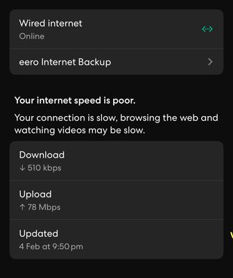

Just to follow up, the eero router app has now caught up with the speeds I was seeing in speedcheckers and test downloads.
currently download is less than 500Kbps (essentially off), but upload is still 75Mbps.
eero router connection speedeero router connection speed
