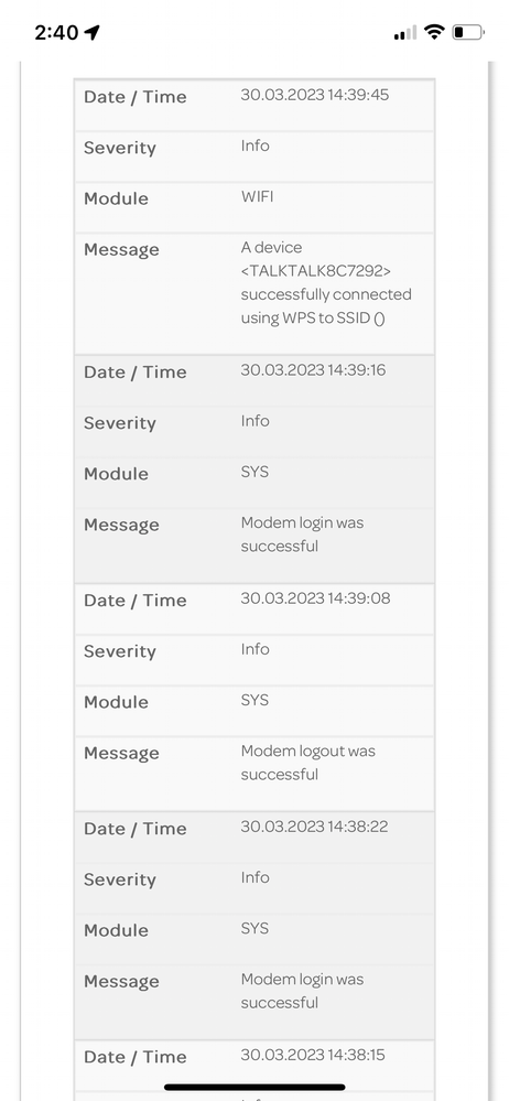

Well, the router certainly went into WPS mode & something connected, but from those logs, I can't tell what. I assume that you are using an iPhone to log into the router?
I need to know the MAC addresses of at least the devices that are not able to connect & what they are. Hence why I requested that you PM me a list of your devices & MAC addresses. This is essential as all the system log quotes are MAC addresses, not any names that you may have for these devices.

Message 5 of 22
Sorry, forgot the WPS

Hi @Philliecheese
Was this from the correct time period, I can see various devices connecting OK, but no indication of WPS being operated.
Are these MAC addresses any of the ones that do not connect (feel free to PM me with a list of your devices & MAC addresses)? A MAC address, if you do not know, uniquely identifies the network adapter in each device. I have included the vendor of each network adapter in parentheses below, in case this helps:-

Hi Keith
apologies, I didn’t realise the data was to be from router logs.
please see attached pics of logs.
