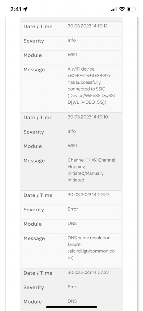

Hi @Philliecheese
Was this from the correct time period, I can see various devices connecting OK, but no indication of WPS being operated.
Are these MAC addresses any of the ones that do not connect (feel free to PM me with a list of your devices & MAC addresses)? A MAC address, if you do not know, uniquely identifies the network adapter in each device. I have included the vendor of each network adapter in parentheses below, in case this helps:-

Message 7 of 22
Hi Keith
apologies, I didn’t realise the data was to be from router logs.
please see attached pics of logs.
98334F9E-6601-4FDF-9610-25EF006E0637.pngE4D9B722-F802-4520-A21F-82A0E255990F.png20920A9C-747B-4E38-8CE7-15C3E8079885.png24F3B4BE-230E-4E7C-A35D-28731D6773C5.pngC40474FB-2B09-4234-94EA-DE6C3F21464B.png74713785-7713-4C7F-B6E6-0CE48B36DA2F.png9DE55929-795D-42F9-9702-1C2F4FD52FCE.png

Yes, you log in to the router via 192.168.1.1 as per the previous screenshots. The Initial screen is known as the dashboard, which I included in the path, hence from that page you go to:-
See internet settings > Manage advanced settings > TalkTalk Wi-Fi Hub > Maintenance > Logs
Keith
