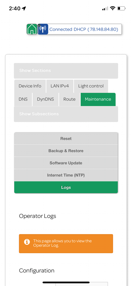

on 30-03-2023 12:06 PM
Hi Keith
apologies, I didn’t realise the data was to be from router logs.
please see attached pics of logs.
on 29-03-2023 12:59 PM
Yes, you log in to the router via 192.168.1.1 as per the previous screenshots. The Initial screen is known as the dashboard, which I included in the path, hence from that page you go to:-
See internet settings > Manage advanced settings > TalkTalk Wi-Fi Hub > Maintenance > Logs
Keith

on 27-03-2023 04:12 PM
The manufacturers of these devices are the people who should know. WPS normally requires a minimum of WPA2 Personal on both router & device before it will work.
If you can try this, it might give me clue. Try to connect one of the devices that will not connect again, OK it will fail, but I need to know the approx date & time it failed. Then can you get me an extract from the router's system log that covers say 15 mins either side of that date & time?
You can find the system log by going to:-
Dashboard > See internet settings > Manage advanced settings > TalkTalk Wi-Fi Hub > Maintenance > Logs
Please note that the First page is the most recent, going towards the Last which is the oldest.
There is no way to actually save this to the device you are accessing the router from, but if you just copy & paste the complete entries for that time period into Word or similar and attach them to your reply, I'll look through them. You may need to visit a couple of pages to cover that time period, just paste them one below the other, so that the newest is at the top & the oldest at the bottom, just like they appear in your browser.
