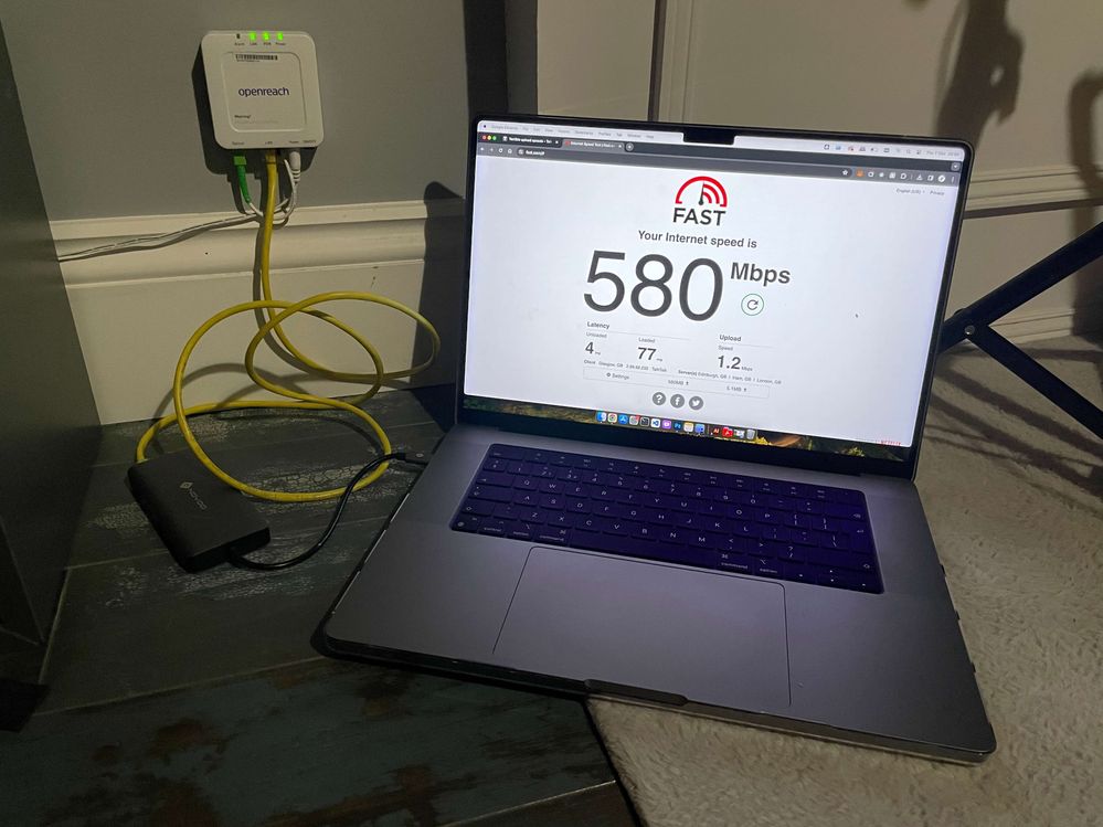

also further back in the thread here is a photo of a single device connected to ethernet directly to the ONT using fast.com and showing 1.2mbps upload
I would say a cable issue can be ruled out as in both cases the download speed is above 500mbps so the cable is capable
