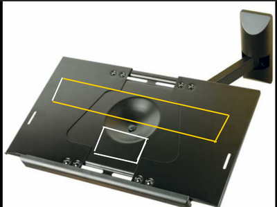

 I totally agree with Keith that you should keep the eero away from other electric powered appliances/devices but as i didn't have much option I had to put it near the TV, it worked for me -
My TV is on an old TV shelf in the kitchen similar to the one below the TV is at the back the eero is at the front (see picture) the TV has no aerial and is connected by Wi-Fi I haven't had any issues with TV reception, signal strength or speed,  could it be something else causing it have you tried moving the eero as far away from the TV as possible to rule it out?
