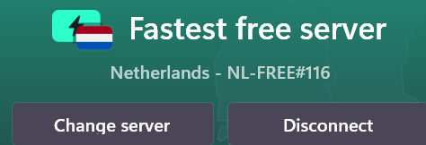

I have run some tests with the latest version of Proton & its fastest free VPN server (the one it chose automatically):-
Fastest free VPN serverFastest free VPN server
My speed test was identical with the VPN connected compared to the normal disconnected speed. I then carried out some video tests by watching some HD content streamed from YouTube, they were excellent.
The problem, therefore, is not Hub 3 related, but possibly a network issue. To prove this, please can you PM me (to protect your privacy) details of the VPN server your Proton client is using, speedtest results with the VPN disconnected & then connected. Finally, can you get me the results from a trace route and the details of your IP connection with the VPN connected? If a Windows PC, from the command prompt, these would be:-
