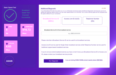

Hi Chris,
This is what I am getting across all my devices over the wifi.
Would you be able to provide me with the Broadband Service ID so I can run a diagnostic test myself?
(I am dying to find out why only the upload speed has the issue, if problem with channel congestion then the download speed should be affected right?  )
I got a Tplink router AX3000 (wifi6) last evening unfortunately the issue remains.
Thank you
Pintu
MrDey
