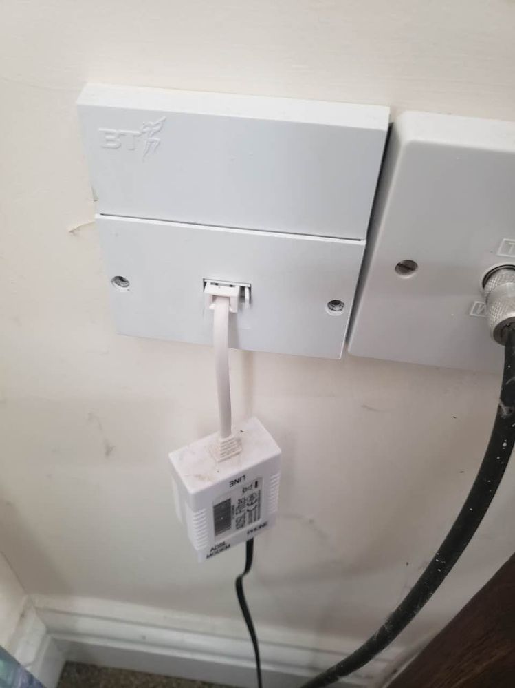

There is a buzzing on my landline on every call, heard by me and the person I'm speaking with, which quickly gets louder as the call progresses. It's been going on for weeks and is very annoying! Thank you.

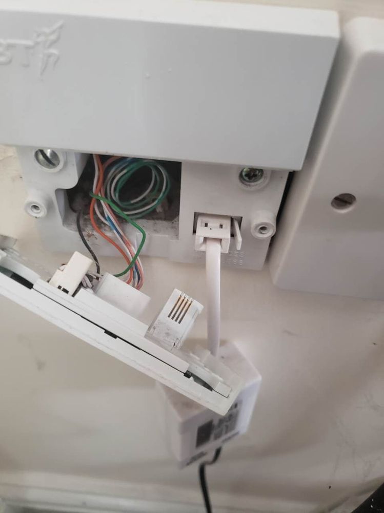

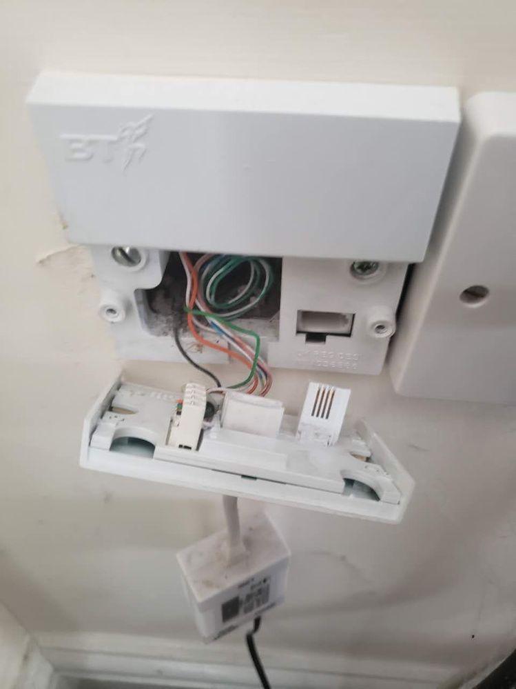

Thank you. Once the faceplate is unscrewed and lifted slightly then the front of the socket faceplate will no longer work until it's re-connected again.
Would it be possible to connect the microfilter, router and the phone at the test socket for 15 minutes so we can re-run the line test again please? Testing at the test socket will just eliminate any possibly issues with the faceplate or any internal wiring.

The faceplate has screws which I can unscrew, between the phone line and the socket is a router so I guess I'm testing that. No idea what a microfilter is?

If your socket is a NTE5 then this should have a test socket as per the help guide pictures.
Here’s how to connect your router to your test socket:
Carefully unscrew the faceplate on your main phone socket with a screwdriver. If your main phone socket doesn't have screws, squeeze the sides of the faceplate to detach it
Now gently pull the faceplate towards you
With the faceplate removed, you'll see the test socket inside. It looks similar to the phone port on the front of your main phone socket but without the sliding cover
If you're testing your router, plug a microfilter into the test socket
Then plug your router's grey broadband cable into the microfilter's ADSL/DSL port
Michelle
