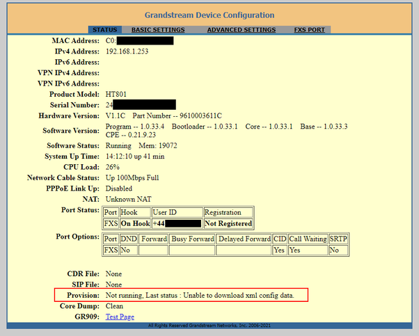

I've tried all weekend to get this to work, but as I haven't been able to get the digital voice adapter to download the config file I contacted Grandstream again and they told me how this should work.
Apparently when you power on the ATA (aka DVA) it connects to your server to get any new firmware and config files. Then the device is reloaded with the new TalkTalk settings, which is how the device ends up being locked down (no web interface, SSH or dialer config options). But for me provisioning always fails with "Unable to download xml config data", so my device isn't locked down and because most of the default settings are wrong the device fails to connect to the SIP server.
Because TalkTalk are using a customised firmware Grandstream can only theorise, but they've told me that if it's not a DNS issue then there's a few possibilities.
  1. Your servers rejecting the username or password from my device.
  2. Your servers rejecting my digital voice adapters MAC address for some reason.
  3. Your servers missing a config file for my digital voice adapter (config file names contain MAC addresses).
  4. The device wasn't configured correctly before it was sent to me.
If I access the DVA and go to the FXS port tab and change the DNS mode from A Record to SRV then my phone does register, but because most of the other settings are wrong I can't make or receive calls. So if necessary, I could reset the digital voice adapter and then leave it connected directly to the ONT for a few hours today? That way someone from the (network?) team could connect to it via the web interface, see what I'm seeing and then make any necessary changes to get this working correctly.
I've added my digital voice adapters MAC address and serial number to my private notes, should your network team want to investigate further.
You might also see a fault ticket created by the online chat, but I don't expect anything to come from that one since they were clearly following a script and they didn't seem to understand how this works.

I left the digital voice adapter connected to the ONT all night long, but the phone indicator still wasn't lit up. So I read your reply and then powered everything off, powered on the ONT, powered on the digital voice adapter, reset the digital voice adapter and then waited 10 minutes. Unfortunately it's still not authenticating though.
According to Grandstream when the port status is displayed as "Not Registered" and provision says "Not running, Last status : Unable to download xml config data." then the issue is likely DNS related as it's failing to connect to both the SIP outbound proxy server and the config server. So it'd seem like something isn't configured correctly on your end or I was sent a misconfigured device?
