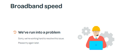

Also - not sure if this has an impact - but when I run a Talktalk connection test I get this...
I don't seem to have any issues with my broadband though - so not sure what the issue is!
