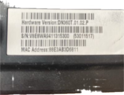

Hi @RMurray ,
What Model TV Box do you have ? Also, under the box is a serial number, can you provide this please.
I cannot see any service discovery logs here, so not seeing any communicatin from your TV Box to our servers etc.
Karl.
