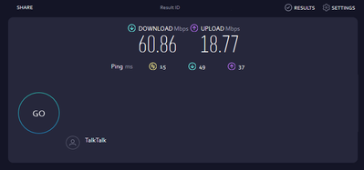

Happy enough now the problems are fixed and as you'll see below I'm currently getting 60+Mbs/18+Mbs download/upload speeds, faster than it has ever been. I'm not counting on that being maintained but as long as it stays in the same region I'll be happy.
