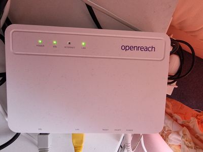

Before, we had a standard one that just said OpenReach but as noted on the new one installed, it says "G.fast" on the socket (see attached below).
Apparently these ones have a specific noise filter for the G.fast service that a standard socket doesn't have which results in the stability drop as the computers from their end would notice the noise instability and reset our connection (he was surprised our internet worked for as long as it did).
He ran standard diagnostics when he came and the line itself seemed fine anyways.
All is working fine for now, will report back if anything unexpected happens again but fingers crossed, I don't need to come back here 😜

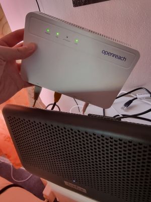

20220427_142443.jpgFor the sake of testing, I have reverted back to the Hub which again, exhibits the issues of dropped connections periodically.

When we originally had the TalkTalk Hub, we found it had issues keeping connectivity for all 9 devices in our house at a given time so we installed a ASUS RT-AX86U router which worked for our connectivity needs.
Since the upgrade a month ago, we hit the same issue in that all our devices could not connect to the TalkTalk Hub at the same time (2 or 3 of our devices would simply sit in a "no Internet connection" state) so we switched back to using the ASUS router (keeping the OpenReach modem)
This configuration has worked without issue for the past month until 2 days ago when the modem would simply "lose internet"
Whilst the internet was down I had to mobile hotspot from my phone but the website indicated my homes internet was fine (despite the modem not having internet)
