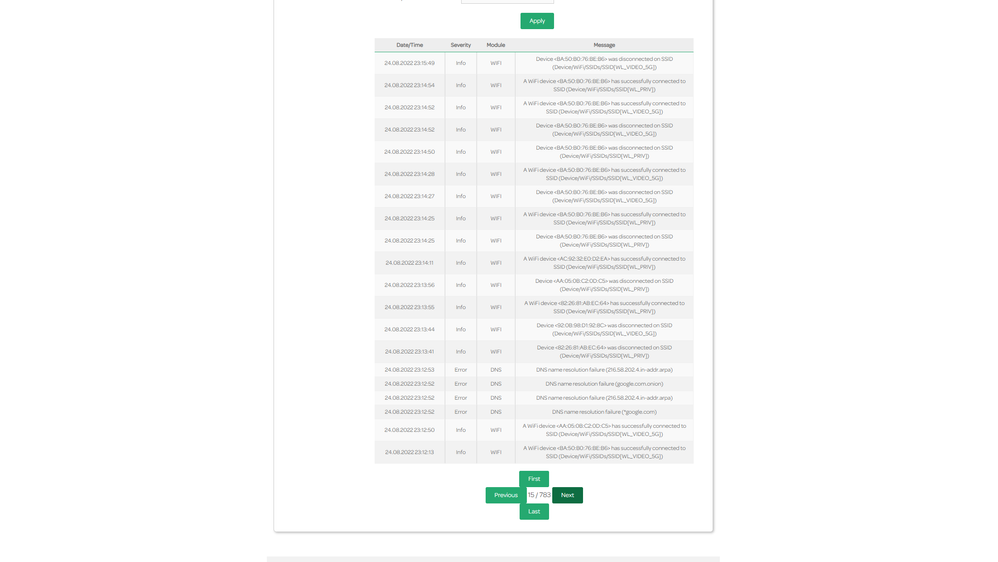

I have been having issues with my connection recently, mainly slower speeds (still hitting 30mbs) and disconnects.
I have just spent 40 minutes on chat with the tech team trying to nail it down, but no errors with the line showing, suggested it may be wiring in my house but nothing here has recently changed.
I was just looking at my router setting and noticed some strange behaviur in the logs. Lots of DNS name resolution failures during the night when there would be no acces on my connection.
Anyone have a clue whats going on or if this could be the cause of my instability?

To be honest I'm not sure if the DNS failures were the cause of the dropouts. My question in my OP was never really answered on that point, whether they either would cause dropouts or indeed if they were normal.
The fact that I now have a much more stable connection using 3rd party equipment leads me to not want to try another TT router. The new one you sent didn't do anything to fix the issues I was having. Plus what's the point if I have already bought the 3rd party kit that I'm now using... at my own cost
I think the best course of action would be to look at your own equipment or to test more thoroughly the routers you are sending out as I am certainly not the only person who is having these issues.
Also I don't have a huge amount of IT experience, but it seems crazy to me to have the DHCP lease set at 15 minutes. Every single talk talk router in the country is sending a renewal request every 7.5 minutes. That's a huge amount of unnecessary network traffic

Apologies, I thought you were just asking about the DHCP lease, I'm sorry for any inconvenience caused by this issue.
I'm not sure why you're experienced DNS issues with the Sagemcom but not with the 3rd party router. As far as I'm aware there are no current DNS issues with the Sagemcom. We could try the Sagemcom again to see if we can see what's going on
