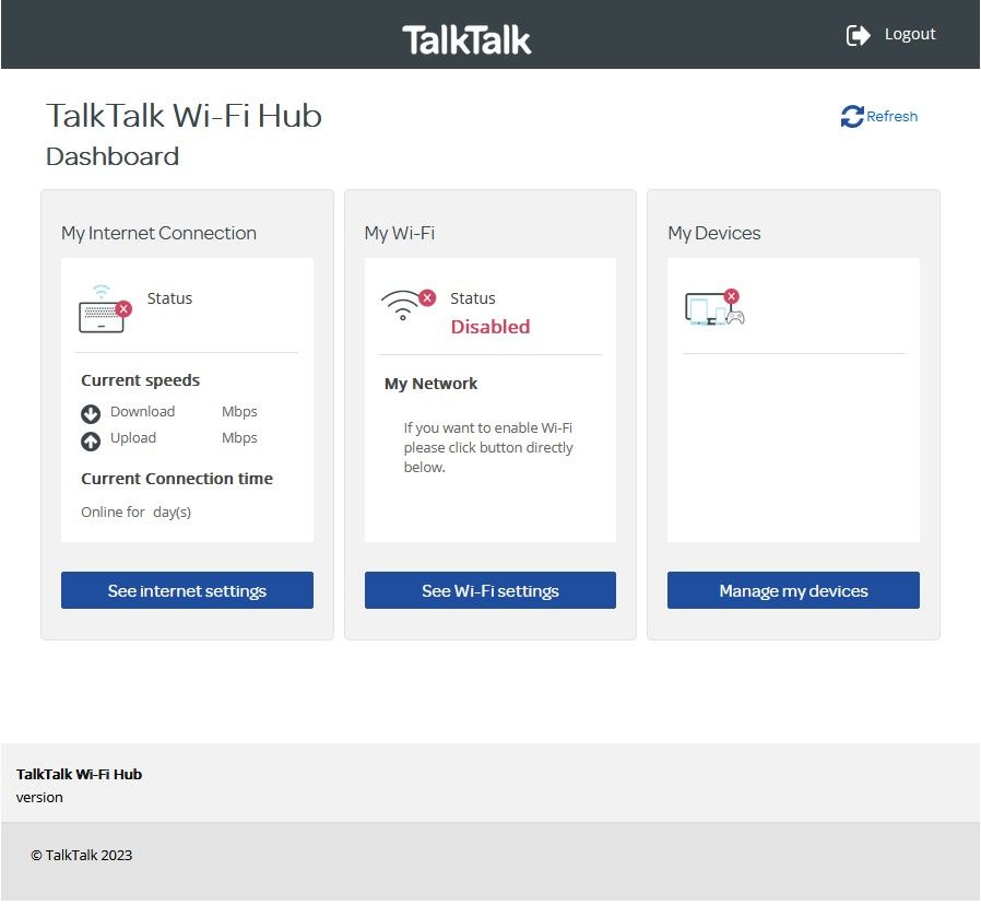

The console is still "flaky" - sometimes it's there and sometimes it's not.
You can tell if it's going to work, even before logging in, if the FW level is showing or not,
It is strange that the login and screen navigation all work but there's no content - and yes, the wifi was enabled and working when I took those screenshots.
Most of the actual functions appear to be stable, except I had a panic a couple of days ago when one of my clients was filling it's event logs with messages about UPnP failures, which matched the timing of events in the router log, that just repeated "UPnP functionality has been activated".
The console session timed-out, and when I which back in it was non-functional, so I powered the router off/on and it all started working properly.
Some interesting features in this FW version, such as "Guest wifi", which I assume allows access to the Internet but not local services (drives, servers, printers)?
Dave

Hi @Warpcoil
@Debbie-TalkTalk has asked me to help with this. The issue that I have seen with V174 is that sometimes when logging in to the router, the GUI just freezes & you have to log out & go back in again. I notice that one of the screenshots seems to suggest that the WiFi is disabled, I assume that this is just the UI misreporting things. However, there is another known problem that if you disable one or both bands, then the only way to get them back, fully functional, is to do a factory reset of the router.
As I have not seen the exact problem that you seem to have, I would suggest trying a factory default (pin reset) of the router & if that does not fix it, then this router must be faulty.
Keith

Quick update
The router seems to be functioning fine, with fewer (but still some) instances of "wifi with no internet connection"
However, the local console is very flaky.  Sometimes most of the panel s work, while other time, such as now, every panel shows a dead box doing nothing without even the firmware version number. Though the box is actually working!
See attached.
and BTW can you have a word with the forum Admins and get them to allow *.jpg attachments and not insist on having to change the extension to "jpeg" every time.  For many people it wouldn't be obvious why attaching windows screenshots doesn't work 🙄
Dave
