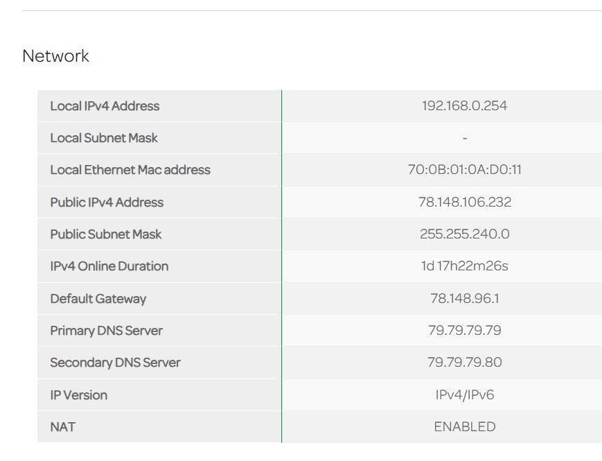

Thanks for taking the time Keith, After some tests here is what I have found out..
Hard reset makes the subnet mask show up in the INFO screen and with the default subnet 192.168.1.xxx allows me to add port forwarding fine.
As soon as I change routers IP to 0.xxx subnet it shows as below and PF gives that error.
In addition - I have just tried the same thing on my dads router (same as mine, HW and firmware) and does EXACTLY the same thing. This suggests its not just me but more a firmware issue. A new router with the same hardware and firmware will probably just give the same results. Is there any way to get a different hardware version or alternative firmware?

Why is there no subnet mask shown in Device Info I wonder, you have set it correctly in the LAN IPv4 page? I have just rechecked my 5364 running a network 10 address with the same subnet mask & that displays OK in Device Info.
I think either the router has thrown a wobbly, or is faulty. Can you first try a factory default of the router & if no better I'll ask TalkTalk to replace it for you.

Cheers keith yea typo - screen shots of config - i did notice the subnet mask asnt showing in the info screen but is correct in the LAN page. Network routing seems fine for internet and local traffic. any help appreciated

Thanks for that @matty_wales70. I am sure this is a typo on your part, but 192.16.0.xxx is not a private IP network and as such is an invalid address for the local side of the router.
I regularly run my 5364 with a network 10 address & it port forwards fine. Mine is hardware revision version 4, there are some bugs with V3 running the last few firmware releases, but I have not seen this one mentioned before. I do test each firmware release on different subnets, but only on V4 hardware as that is all I have.
Please can you confirm the address range & if you get any error messages? Please also include a screenshot of your PF rules in question.
