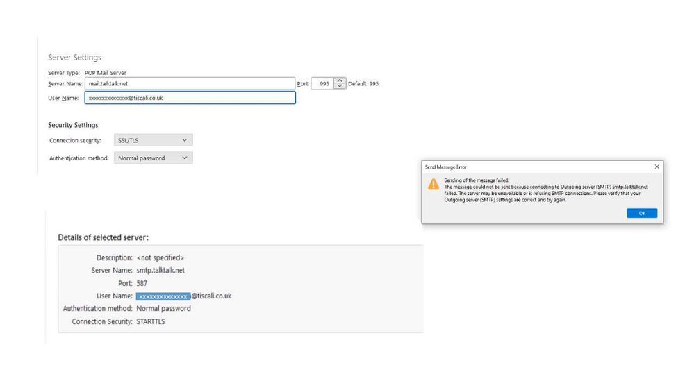

Since Thursday 23/02/23 we have not been able to send Tiscali emails. We can receive emails but not reply/send.
Our device is a Windows 10 laptop.
We are using Thunderbird to access emails and do not want to use Webmail.
We have changed all the server settings to exactly what we were told in a TT email. We have rechecked these hundreds of times.
We have successfully changed the password on the Webmail and can send emails from within Webmail.
We have tried read this forum and tried everything and it still doesn't work.
We get an error message basically saying, the message couldn't be sent because connecting to smtp.talktalk.net failed.
Could you please explain what we should do in non-techy language. Thank you very much.

on 02-03-2023 06:50 PM
Message 8 of 21
I agree that if the mailbox is not limited for receiving or sending and if it's receiving incoming mail ok then we need to troubleshoot other reasons for the outgoing mail SMTP server not accepting the connection.
If the settings are as you originally showed and that's still coming up with the 'refusing connection' error message then the most likely reason is the SMTP server thinks the password is too weak.
So upgrade the password, try sending again with Thunderbird and put in the new password when prompted.
The Reset password now button in the help article Changing your email password will take you to password reset and recovery.

on 02-03-2023 06:33 PM
Message 9 of 21
I have already posted a photo of the server settings as requested, and they have not changed. The port for the outgoing server is set at 587, not 25.
Please see below.
I do not understand why you say Thunderbird is set up insecurely.
I have never been asked to accept a new certificate.
I successfully changed the password to access Webmail and ticked the box so that Thunderbird uses it each time automatically.
Why then do you say Thunderbird is set up insecurely?

on 01-03-2023 10:56 PM
Message 10 of 21
There was a Service Status message indicating that from 23 February some users would not be able to send mail but could receive mail. "Changes are being made to our Email service to prevent any customer from sending emails from email software or apps which are not setup to support Encryption."
This means that, as Ady confirms, your mailbox is not limited to webmail only as we thought, but does have insecure sending via port 25 blocked. Thunderbird is clearly still setup insecurely.
On updating the Thunderbird email software Server Settings (incoming mail) and outgoing SMTP server setting you'll possibly be asked to accept a new certificate (yes, accept) and to enter the email password when using Thunderbird to read or write emails so have the current password ready (when you've set a new password). Tick to remember or save the password before entering it. Each email address needs to have it's own settings and its own outgoing SMTP server because outgoing authentication requires the email account User Name and Password.
User Name is the full email address and Password is the email password.
- Start Thunderbird
- Select the Thunderbird triple line menu top right
- Select Account Settings from the menu
- Select Server Settings under the email account name in the left side panel
- Use the entries as shown in the table
- Look down the left side panel to Outgoing Server SMTP
- Select Edit to update the Outgoing server settings as per the lower entries in the table below - remember to select the correct Outgoing Server for the correct email account.
Thunderbird email client settings for all TalkTalk Mail domains including talktalk, tiscali and their sister email addresses are:
Account Type | IMAP secure Email Account |
User Name | Full email address |
Password | Email password |
Incoming mail server (IMAP) | mail.talktalk.net |
Incoming Port | 993 (see note below) |
Incoming Connection Security | SSL/TLS |
Authentication Method | Normal Password |
Outgoing server (SMTP) | smtp.talktalk.net |
Outgoing Port | 587 |
Outgoing Connection Security | STARTTLS |
Note: If you use POP3 then the only difference is in the incoming mail server port that is 995 for POP3 secure.

on 25-02-2023 08:31 PM
Message 15 of 21
The error message is from Thunderbird because TalkTalk have removed access for Thunderbird as per the notification message from TalkTalk.
As you now have the correct settings updated for Thunderbird then I'll request access is restored. Next week TalkTalk Support will respond right here and access will follow a couple of days later. Until then use webmail.

I hope this is what you asked for, the incoming and outgoing server settings and I have added the error message

on 25-02-2023 04:12 PM
Message 18 of 21
No, the message you mention is not the one we get. The message we receive is about a failed connection to smtp.talktalk.net.
We weren't asked to accept any new certificates or invited to put in any password when we changed the settings over to the new ones.
The settings in your panel are the ones we are using.
I will try to upload the shots you want.
Thank you for your help.

If you saw the message from TalkTalk advising "Our records show that you are still accessing your email using unencrypted email settings, because of this you will no longer be able to receive or send emails via this email app or software" then the email address receiving that notification has been limited to webmail only access as a last resort action by TalkTalk to stop the use of insecure email.
TalkTalk Mail webmail is secure by design using an up to date Internet browser.
Select here: Sign in to TalkTalk Mail
Enter your full TalkTalk Mail email address and password, select Sign in.
You will be able to get email access restored to email apps or software including mail collection services so long as you're ready to use up to date and secure email settings for all the ways you view emails. We can advise on device and software compatibility and provide customer setup guides. Just let us know each mail collection service, each device, its operating system and email software including version that are in current use.
Settings for Thunderbird are given below.
On updating the Thunderbird email software Server Settings (incoming mail) and outgoing SMTP server settings, for any active mailbox that does have IMAP / POP3 access, you'll possibly be asked to accept a new certificate (yes, accept) and to enter the email password when using Thunderbird to read or write emails so have the current password ready (when you've set a new password). Tick to remember or save the password before entering it. Each email address needs to have it's own settings and its own outgoing SMTP server because outgoing authentication requires the email account User Name and Password.
- Start Thunderbird
Thunderbird email client settings for all TalkTalk Mail domains including talktalk, tiscali and their sister pipex email addresses are:
Incoming Port | 993 |
However, if you happen to have a POP3 account then the only difference to the above table is the incoming server port that's 995 for POP3 secure mail.
For a definitive check of settings take screenshots of the incoming and outgoing server settings, image edit to obscure the first part of the email address and upload here using the Camera icon (desktop browser) or Picture icon (mobile browser) above this reply area.
When you confirm the secure settings are ready I can request TalkTalk Support to restore full access. TalkTalk Support will respond here and access will be restored usually within a couple of working days.
