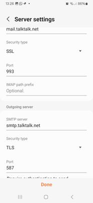

To clarify, the Samsung email app server settings are:
IMAP Incoming server: mail.talktalk.net
Security type: SSL
Port: 993
SMTP Outgoing server: smtp.talktalk.net
Security type: TLS
Port: 587
Require authentication to send emails: ON
I couldn't see the authentication setting in the screenshot but otherwise, if you're sending from the TalkTalk Mail account that is authenticated with its own full email address as Username and the sending email password then that should be authenticated as the settings that I can see you have are good.

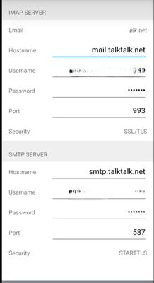

Tried 2 different email apps with the settings as shown in the attached pictures. Neither allow me to send emails. When sending via Web browser I get the following message (TT608).
Not connected via any VPNs.
Same thing happens with 2 different email addresses connected to same talktalk account. Neither can send on respective phones.

Finally double check the Samsung outgoing server settings, take a screenshot, image edit to obscure the first part of your talktalk email address and upload here using the picture icon above this Reply area. I'll take a look and advise further.
