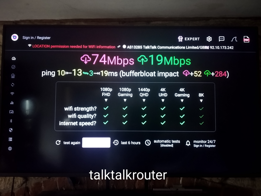

Apparently the QBox uses dual band to a Sky hub, but the sat box setup is very limited and doesn't  give any details , we have a Panasonic smart TV very close to the sat box, and can  run apps on it so did one today showing the speeds, to both the mesh ( line of sight WiFi) and the talktalk router, which is either round a corner through a door ,or through the thick stone wall. , if this of any help.
Both seem quite quick compared to the advertised speeds, have very little problems in the daytime, but early and late evenings it's the worst, which makes  think it's might be bandwidth throttling.?
C
