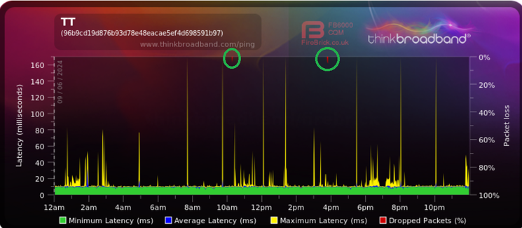

I can try to see, but the noise is not consistent, in fact it's sporadic. It also disappears if you hang up and then pick up again.
Annoyingly after reading your message I did pick up the phone and it did sound like there was a fair bit of noise on the line.  Unfortunately I put the phone down as I walked downstairs to the master socket to disconnect the router.
However I picked up the phone again just before disconnecting the router and the noise was gone. That was in the space of about 20 seconds.  I did try disconnecting the router regardless,  but it made no noticeable difference to the sound at this point.
Other times when I think there's a little bit of noise on the line when I'm listening to the dial tone, if it gets to the "Please Hang Up" message which happens after about 15 seconds, the message is perfectly clear with no noise what-so-ever.
The third and final issue is - generally it's my gran that calls, and the crackling on the phone line happens not only when she calls us but when she calls others (mentioned in this thread).  However, the two calls on saturday with noise were not from her.  They were from two different people - the first a landline, and this was the call that was disconnected, the second was a mobile where I asked the person to call again because it sounded like someone was attacking the line with a cheese grater.  The noise was gone when they called back, but as I stated previously, this is always the case.
If I look at the Think Broadband graphs, I can see packet loss frequently when people have called.
Here's the 9th, phone calls circled.
Here's the 8th, the call where we were disconnected is in orange, the one where it sounded like there was someone attacking the line with a cheese grater is the long green oval.
Many thanks,
Rob_B

No internet disconnections so far, but it has felt like the internet 'stalls' when we've had phone calls.  The Think Broadband graph has shown some packet loss spikes, I think one coincides with the below.
We have had 2 phone calls today which had noise on the line, one of which the phone disconnected (3.01pm today).
Many thanks,
Rob_B
