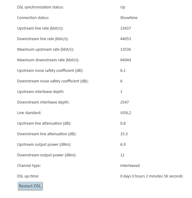

Hello,
I'd appreciate some help please if at all possible.
Twenty year long talktalk customer, 'upgraded' from Fibre 38 to Fibre 65 September 2022. I received 38 meg download speed before the 'upgrade' and continued to receive exactly 38 meg subsequent to the 'upgrade'. This speed is below the minimum expected for the Fibre 65 contract.
Submitted line test and opened fault on 26/10/2022. Spoke to multiple advisors over the next couple of month and was told the service is fine and no issue with speed, despite being below the minimum expected of 40.2 meg.
Finally got talktalk tier 1 tech support to verbally confirm over the telephone on 07/04/23, that the linespeed is below the minimum standard. Openreach engineer booked for 08/04/23, arrived, checked socket (BT Mk4) and was told internal wiring is fine. Openreach engineer went to the external green cabinet and changed the linespeed to 45 meg (fixed at 45) and said that is the best he could do and left it at that.
Current statistics:
Actual Upstream line rate 13090
Maximum Upstream line rate 13256
Actual Downstream line rate 44523 (fixed at this speed)
Maximum Downstream line rate 63968
Downstream noise safety coefficient 7.2
Downstream noise safety attenuation 15.3
Approx 200 metres from green cabinet.
After 6 months of waiting, I'm grateful for the increase from 38 to 45 meg, however it would appear that a maximum rate of 63968 would indicate that there is still significant room for improvement. I have no interest in upload rate and if it can help, I'm happy for upload rate to be reduced to 5 meg if it helps to increase downstream rate.
Can anybody from talktalk tech support please take a look at these statistics and see if you can do anything to help, much appreciated.
I also require a firmware upgrade for the router. I'm happy with the router and do not require a replacement or upgraded router.
Best regards.

on 04-05-2023 02:06 PM
Message 8 of 25
Hi Karl,
The HG633 firmware is currently 1.15t which is old firmware, see attachment. Firmware version 2 is available. Can we push ahead and update the firmware in order to improve security?
Regarding the billing team, can you confirm you can and will add full and correct reference notes to the account, to ensure that after 6 months of waiting, I'm not left with having to argue with a member of the billing team, who may choose to provide obstruction due to a lack of clarity regarding the account notes? If not, can you confirm whose responsibility it is to add full and correct notes to the account and point me in the correct direction?
Many thanks and much obliged for your assistance..

on 02-05-2023 01:23 PM
Message 15 of 25
Hi Debbie,
Sagemcom router connected as directed.
Current statistics:
Actual Downstream line rate: 40252
Maximum Downstream line rate: 45860
Downstream noise margin: 0.00 - Sagemcom router is not reporting any statistics.
Downstream attenuation 20.9
All round worse performance than HG633 at this point.
Thanks for you assistance.

on 01-05-2023 02:05 PM
Message 17 of 25
Hi Debbie,
I received the Sagemcom router however I'm afraid the line performance was significantly worse using that router. I'm not sure if it was a faulty router, afterall it did work and looked in healthy physical condition. I tested it with the adsl and filter supplied, also with two of my own filters and also via the Openreach Mk4 faceplate and the statistics were similar in all scenario's.
Sagemcom statistics:
Actual Downstream line rate 39063
Maximum Downstream line rate 51073
Downstream noise safety coefficient 12.7
Downstream noise safety attenuation 23.5
Switched back to HG633:
Actual Downstream line rate 44500
Maximum Downstream line rate 64951
Downstream noise safety coefficient 6.9
Downstream noise safety attenuation 15.2
Unless there is any specific reason that requires the Sagemcom router to be used, I will pack it up and return it. Can we push ahead and upgrade the latest firmware on the HG633 so that it fully patched please?
Any other suggestions that might help?
Best regards.
