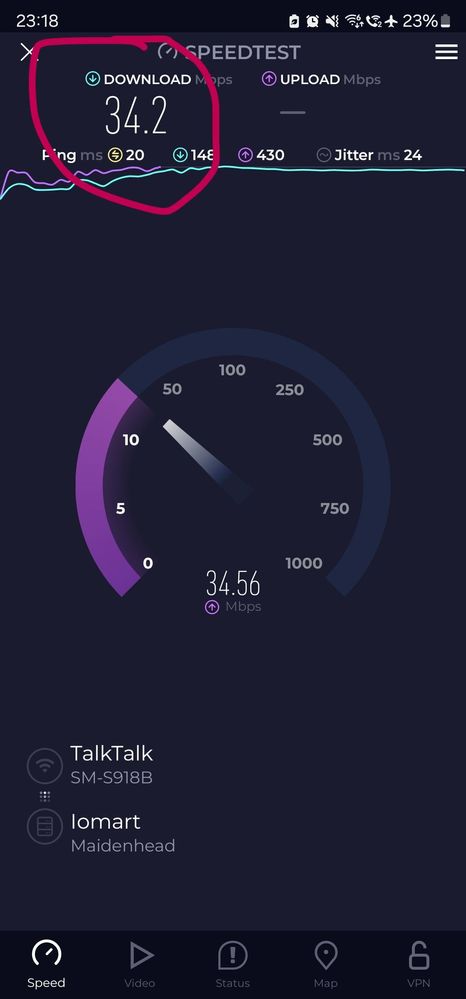

I have been using Full Fibre 150 for 3 months, and unfortunately, the experience has not been great so far...
I have got multiple connection drops every day, where the connection speed drops drastically.
This is an example from this morning, where I am just getting 92Mbps in the Eero app when I should get around 150Mbps. Speed is even less over WiFi (around 60Mbps - I did the test 1 meter away from the router connected to 5GHz band and WiFi 6 enabled).
Here the speed test done with the Eero app:
Eero test speedEero test speed
This is the speed in my Galaxy S23 Ultra:
Samsung SpeedSamsung Speed
And this is the speed in my Windows 11 PC:
Windows speedWindows speed
I have experienced this speed issue from the begging of the service. Today I am getting 60-70Mbps, but some days is even worse, around 30-40Mbps.
The connection is not always that slow, but I have noticed that it works slow the majority of the time. Restarting the router seems that helps, but after 1-2 days, the issue appears again, and I should not be doing this 3 o 4 times per week.

The Wi-Fi is indeed problematic throughout the property, although it is mainly occasional short breaks affecting the devices. I haven't as yet seen anything in the analyser screenshots that prove this, as these breaks are very random. However, they seem to happen several times a day to different devices. The customer @magames has also purchased a second Eero, but this has not resolved the situation.
Would you be able to replace the existing Eero to rule out a hardware fault, please?
