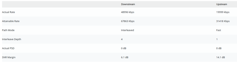

I'm seeing the following on my modem (Draytek Vigor 167) DSL Status page
I'm experiencing quite patchy broadband in the recent days, especially today. I've been dropped out from calls and meetings. ping constant shows network is unreachable packets in dozens or more at a time.
I did see DSL led blinking (searching) on the modem at the same time when packet loss happen.
An engineer visited me recently as a pair of cables got worn out after a renovation in communal places in the building. Engineer told me that we might see each other again.
Can someone see similar signal quality issues from talktalk side on my installation? Would appreciate some real help as I work from home and fast & reliable network is crucial to me.

I'm aware of that the line disconnected twice. ~2pm yesterday and at some point ~4am this morning. I didn't change anything on the setup nor restart any device.
SNR is looking great on both down (~18) & upstream (~16).
Current metrics

Just for the record.
Yesterday morning SNR and attainable speed went up to ~17db and 100000+Kbps just as in normal days. Sadly SNR dropped ~2pm as 13db, 6db, 1.3db then line disconnected. I was looking at the modem UI to see this unfold. All my devices run 24/7.
After reconnecting snr settled ~6db and attainable speed is ~67000Kbps and my actual speed max out at ~48Mbps
As is 08:03am this morning
I do hope this gets better on Wednesday or some action will follow to permanently solve this as I'm getting annoyed not seeing any long term progress for a while now.

Message 18 of 64
Is it clear now? I see this on the talktalk device UI
shouldn't be 65 or so when everything is ok?
