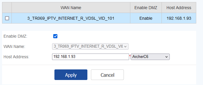

I am currently using the Talk Talk Hub with Fiber 65 package. I have been linking the modem/router to another route from LAN (Hub) port to WAN (third party router) port.

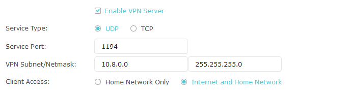

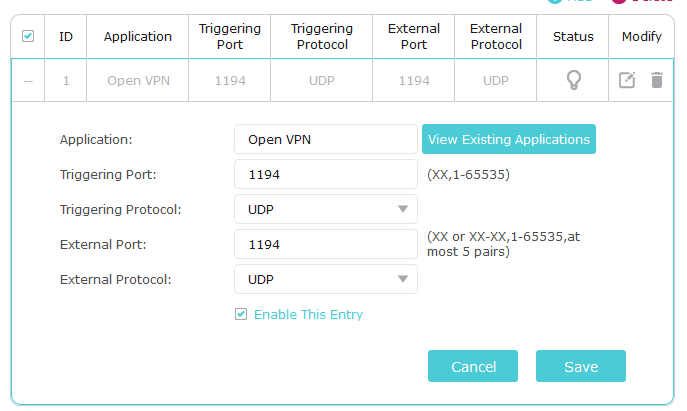

I am attempting to forward port 1194 so that I can use a VPN service I have set up. I have tried this by using port triggering and IP4 port mapping on both routers, as well as using DMZ to forward the info to the third party router. none of this seems to have worked when I have tested the port.

Initially removed the TT router from the DMZ, it is totally unnecessary and make sure that you have not altered it's firewall configuration. Remove the rules from your Archer. Then add port forwarding to the TT and to the Archer again, but no port triggering. In the TT leave the WAN name as Auto.
Then get me screenshots of them if it still doesn't work.

Router 1: Talk Talk Wifi Hub - EchoLife DG8041W Home Gateway
IP: 192.168.1.1
DSL connection for internet to the hub
Wifi Disabled.
Router 2: TP link AC1200
IP: 192.168.1.93
Internet Via WAN port from R1 Lan Port Via Ethernet cable.
The VPN asks for UDP but I have tried both, separate and together, and neither have seemed to work.
DMZ pointing towards TP link RouterDMZ pointing towards TP link RouterTP Link Port TrigTP Link Port TrigTP Link VPN settingsTP Link VPN settings
