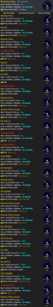

Ok, did some checking with analyzer, pictures below:
speedtest
GenMaxiu

on 14-08-2024 04:29 PM
Message 11 of 31
I am using android version of WiFi Analyzer (paid).
https://play.google.com/store/apps/details?id=abdelrahman.wifianalyzerpro&hl=en_GB
Will do as per your request and update this thread accordingly.
GenMaxiu

on 14-08-2024 04:24 PM
Message 12 of 31
Which WiFi analyser?
Generally the AP view, 2.4 & 5GHz channels plus signal strength over time graph run for 5 mins. However, best is always WiFi Scanner if Windows, capturing a snapshot & report.
Keith
