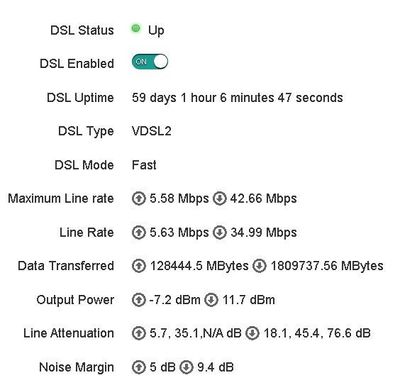

on 10-06-2024 10:25 AM
Message 4 of 14
Thanks,
I don't think an engineer visit will help as this was previously checked and updated to latest socket type.
As the Maximum line rate showing is 42Mbps, but it only runs at 34.99, is it possible it has only been set up as a Fibre 35 service rather than a Fibre 65?

on 07-06-2024 10:33 AM
Message 8 of 14
Email gave estimated speed range as between 22.15 Mbps and 53.76 Mbps.
Router shows Maximum line rate as 42.66 Mbps down, but only running at 34.99

Thanks, I've added phone number the "location" field as there isn't anywhere obvious for landline.
Below is what I see on the router
Show option menu
