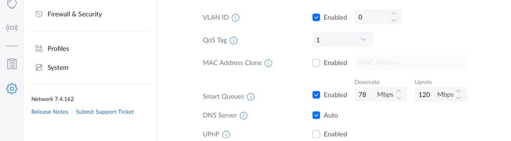

Cloud or remote access has been around since these devices were launched but it’s entirely optional and can be disabled. Either way you have full local access to configuration. From an admin point of view the cloud access is great because I don’t have to go to site to change settings.
Note these are prosumer units and not plug and play so require a level of interaction to configure properly. That said most good routers should also provide options to customise all aspects of a network.
Note the screenshot I post was from local access not cloud access.

Was trying to upgrade from 7.4.92 to 7.5.156 and it no longer allows VLAN 0 in either the new or "legacy" interface. This breaks the ATT bypass which requires VLAN 0 to talk to the ATT gateway.
Well that’s interesting because 7.5.156 does not exist, but 7.4.156 does I’ve been running it and in fact now running 7.4.162 and it still has VLAN ID 0.
VLAN IDVLAN ID
The post refers to a USG which is a different device. 7.5 Will be another release in the future but nobody knows what it will contain or change and that can be said for every single firmware release for any device.

I've used many routers with TT so there is no restriction from TT on using your own router, this was particularly true for ADSL/VDSL services. However with FTTP Fibre services the VLAN ID is important. The fact you have a router than does not allow a VLAN ID of 0 is not the fault of TT but more a fact that the router you have purchased is not fully compatible with the FTTP service.
If TT can change the VLAN ID that is great for you, but if not then you will have no choice but to find a compatible router.
I'm currently using a Unifi UDM router with TT Full fibre and all is good. The VLAN ID can be set to zero.
