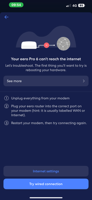

You were too late unfortunately. Despite not wanting to I unboxed one of the eero devices and as I suspected it having success being allocated a WAN DHCP address either.

Hi,
I've asked the team again to double check and confirm this now. Would it be possible to just test the eero just to see if you are able to connect as this will help us rule out an issue with the current router. You would need to follow the eero app to set this up.

Morning -
The eero routers arrived late yesterday, but they only have two Ethernet ports on them, one of which is used as the uplink from the ONT. This isn’t compatible with my home, I have hardwired Ethernet throughout which terminates adjacent to the fibre ingress.
Luckily, as per Chris’s original reply, I can use my existing TalkTalk router.

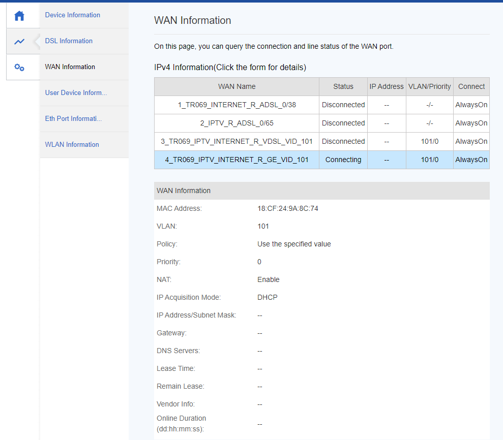

Hi Chris -
Thank you for this. The Openreach engineer has now installed the ONT, but when connecting it to the WAN port of the router no connection is available.
The engineer called TalkTalk support and she advised that he should end the job as TalkTalk would not be able to liven up the connection while the job remained unfinished.
So I've been left with no internet. Can you advise how I get an update as to when the service will be enabled? I'm tethering from my mobile at the moment but it's no ideal as both my wife and I work from home.
Are there specific configurations that I need to make to the WAN on the router (i.e. VLAN ID, etc.) so that it ready when TalkTalk enable the connection?
Chris-TalkTalk
Message 40 of 41
Hi Jmoorey1,
Yes, it should work with your Future Fibre service
Chris
