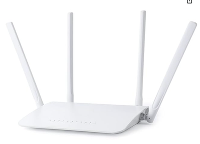

30-11-2023 09:36 AM - edited 30-11-2023 09:38 AM
Hi @Michelle-TalkTalk I have an Eero and two of the routers shown below.
An elderly friend also a TT customer had fibre150 installed by cityfibre on the same day, she got a Hub and has been problem free.
I have two of these using ethernet cables to remove notspots upstairs and at the opposite end of the house, they cost £14 each from a well known online seller. I have set them up so that they are broadcasting 5hz on channel 120 upstairs and channel 52 downstairs.
