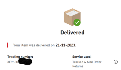

The replacement DVA has just arrived which as the problem turned out be be elsewhere is not required. There is no return label or bag, would it confuse things if I sent it back in the same bag as my old router? I opened the delivery bag carefully and the DVA box is unopened, I could put a large note on it saying it is not a used return.
