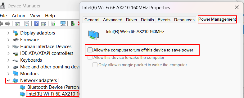

HI @DJA9-Eero
This channel is actually outside of the DFS range. The problem here is that this channel might be too high a channel number for some WiFi adapters to use. However, if this is the case, then this won't make your WiFi connection intermittent; it will not be able to use this channel at all. You will be forced to use the 2.4GHz band, at a guess.
I would think that an Intel AX211 would be able to use this channel OK. However, if it is intermittent, then I doubt that you are using that channel at all. Look in the device menus to find what channel it is using & then we might be able to address this. With a Windows PC, one of the most common reasons for the WiFi adapter itself to stop working is power management. To check this, go into Device Manager. Expand the Network Adapters & find your WiFi card. Right-click that & go to Properties. In there, under the Power Management tab, make sure that this option is unticked:-
Power Management
