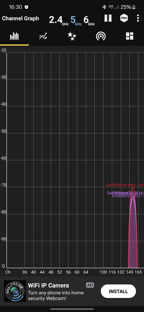

3 days ago I upgraded from Fibre 65 to Fibre 150 and received the new eero router.  I set everything up and all was fine, my TV's and PC all connected on 5ghz and I was getting the promised speed of 150mbps but the following day I ran another speed test and it had dropped significantly to 35mbps.  I checked my connection and found my TVs and PC where now on the 2.4ghz band.  I messaged support and eventually they told me to delete my eero network via the eero app which I did.  I ran the set-up again and my TV's and PC all connected to the 5ghz band, brillant I thought, solved.  They all stayed connected for the rest of the day so the following day I checked again and frustratingly they again were back on 2.4ghz.  I have found in this community others experiencing the same issue but can't see it there's a solution.  I did read one thread where the 5ghz band channel range was too high for some devices.  Using WiFi Analyser I can see my 5ghz band is up around channel 155, could this be the issue?
At the moment my main house PC has gone from 75mbps of Fibre 65 service to 35mbps on Fibre 150 so it feels like a downgrade.  Any solutions out there please?

Hi Michelle, just to let you know Friday's update changed the channel of the 5GHz band to channel 36 and now all my 5GHz devices can now connect.
Thank you for your persistence with this issue.

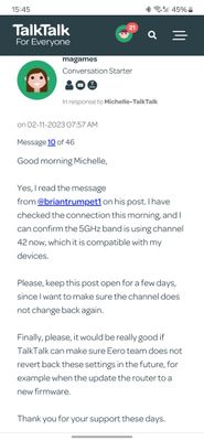

 Ok Michelle and I thank you for your continued help with this but I am frustrated this is taking so long to resolve. In the attached screenshots another user in November last year had the same eero issue fixed by the Talktalk team quicky and had their 5GHz band changed to channel 42. Can this not be done for me?
Thanks,
Ian.
