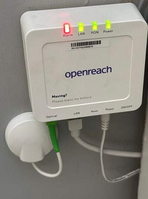

Hi All
I was wondering if anyone has knowledge of the below ONT box that was installed in my property by TalkTalk?
I have been having a few issues with the line since December, but yesterday I have noticed the alarm light is solid red. My connection is still active so it hasn’t dropped so really not sure what the alarm means.
I have asked the online chat who advised my line seems fine and closed the chat, which isn’t the reason I wanted to chat with them I just wanted to know is the red light something I need to worry about or hot so if someone could help that would be great 🙂

I left the box turned off all night, turned it back on this morning and did another factory reset and everything seems to be fine now.
It’s been a couple of hours and the alarm light is still off no problems, I did text an automated message from openreach to say the issue is fixed but could you just make sure the appointment has been removed?

As far as I am aware this ONT is remotely controlled and software is automatically downloaded from the exchange (headend/ODF) which should also have the appropriate Adtran equipment.  It is possible that the problem is at the exchange end, particularly as you state you have had other problems.
I see you have factory reset the ONT but as a long shot I would suggest turning it off for at least 30 minutes and then see what happens.  All guess work but it might allow the headend to do a reset.  Does the Alarm LED go green or flash green shortly after switch on or does it go straight to red?

Hi softy
Thanks for the information really helpful! Don’t suppose you know how to get it out of failed status? I’ve tried factory reset a couple of times but that doesn’t work.
Softy
Conversation Starter
Message 9 of 15
Just for your information.  Openreach have been installing this ONT in many places for a while and it is made by Adtran (manufactured in USA rather than China).  I believe it is based on their SDX611 GPON ONT but specifically made for Openreach.
The Alarm LED has several meanings.
Off = No alarm detected.
Green = ONU software download complete and software upgrade in progress. LED will turn off once upgrade is successful.
Green Flashing = Software download in progress.
Red = New ONU software not operational due to any of the following reasons:
* Software image download failed.
* Software image flash write failed.
* Software image activation failed.
* Software image commit failed.

Hello,
Ah yeah I remember. I think we should arrange an engineer to the property to check this as the light shouldn't be on. Would you be able to provide a few days availability AM and PM and we can book the engineer visit for you.

Hi Michelle
The box was installed late December along side the FTTC line, I did have another post in relation to 100% packet loss when online gaming that I’ve been experiencing since install which is still with the tech team as an on going issue.
I have restarted the ONT and both eero routers & even pressed the factory reset button on the ONT and the light stays on.
Could this be linked to the on going issue I’m experiencing if this isn’t the ONT you have on file?

Hello,
Can I just ask when this ONT box was installed please? It looks a little different to the ONT in our help guides. I've checked the line test just to see if this has detected any issue and this looks ok. What issues have you been experiencing please? Have you also tried powering down the ONT to see if the light is still red when it comes back on?
