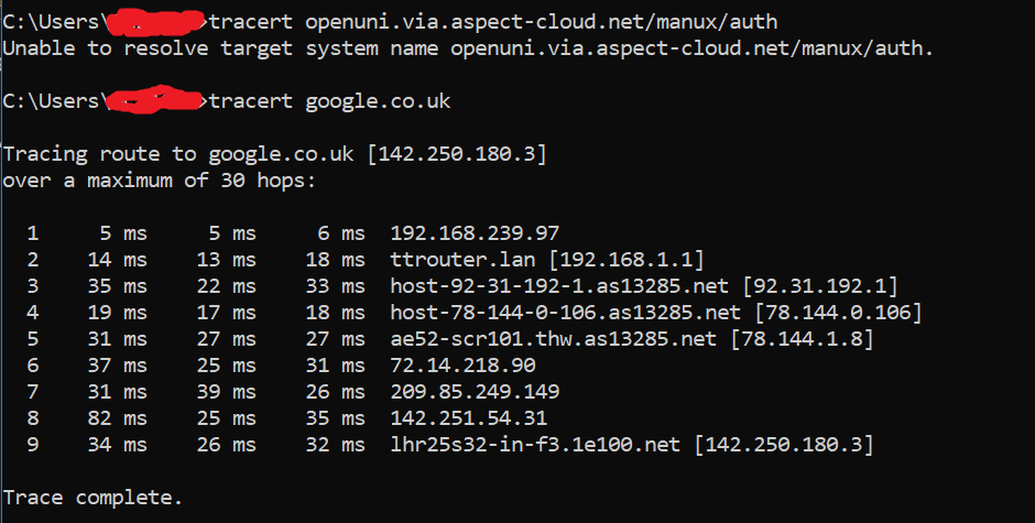

FYI, you should "tracert  openuni.via.aspect-cloud.net".
It's tracing a route to the server, not a URI on that server.

dc1990
First Timer
Message 8 of 12
Hi Karl, I wasn't able to message it directly. Please see traceroute below
traceroutetraceroute
