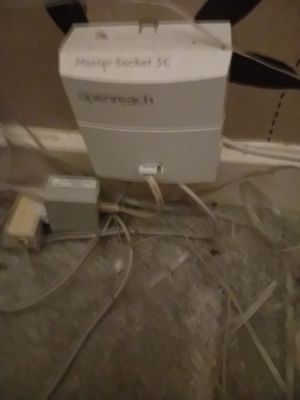

Can someone explain to me how this fibre thing works.   I have a square white box on the wall into which my router and landline plugs in.   Am I to understand that this is a copper line connection?  My landline is due to be disconnected on 18th March (I have taken out a new contract for fibre 150 data only) and I have been advised to make sure that the router is connected to the fibre connection box on the wall.   In this email they showed pictures of two boxes. one white and one black.   I have no such box on any wall in my home.   Now, I am not au fait with all things technical but this says to me I do not have full fibre in my home.  What I am concerned about is that come 18th March when the landline is disconnected I will also be disconnected from the internet.  Am I correct or worrying unnecessarily?   Any thoughts from anyone?

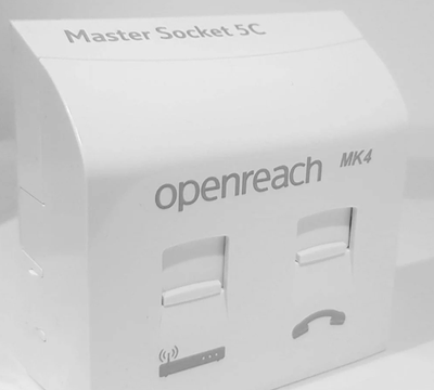

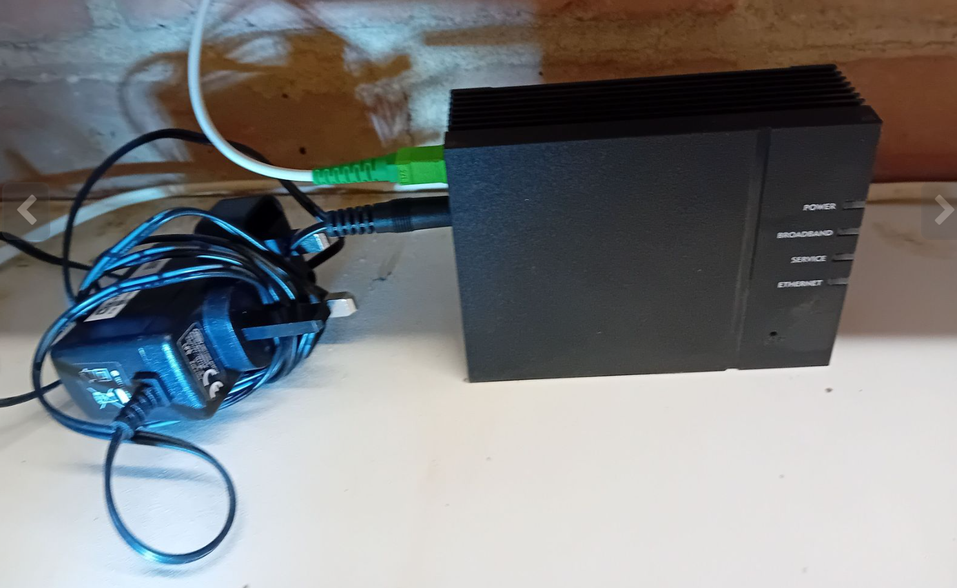

You have old copper broadband inside your house, with the white Master socket
and you have the newer Full Fibre broadband in your shed with the black ONT, which is currently unfinished.
You will certainly need the engineer to come and somehow finish what was left unfinished in 2019

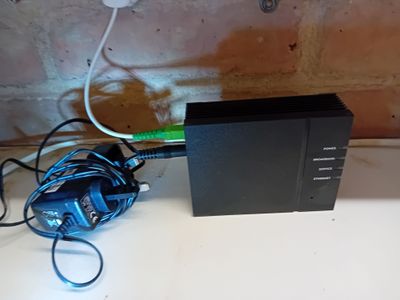

Nothing is connected to the box in the shed

 I have had no installation since taking out fill fibre data only.   However, if my memory serves me, in 2019 someone did visit and dug up my front garden and installed a small box thing which is in my outside shed, not connected to anything.  Could this be why TalkTalk thinks I have full fibre connected?   Told you, I am not tech savvy!

OK, well just to be clear, have you had any additional installation done since you agreed the Full Fibre data only package? Can you perhaps post a picture of the existing box you mention?

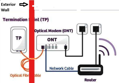

When the engineer visits he/she  will install a new box on the outside wall called the Termination point (see diagram at bottom) and an ONT on the inside wall,  the ONT  will look something like the box below but the names on the lights may differ slightly, this is where the fibre cable leaves the termination point and  goes through a hole drilled in the wall and into the ONT (green connector) the other two cables are one Ethernet which goes  to your router and power supply.

This is how your old internet and phone connected using copper lines  if you go full fibre and do not agree to pay extra to keep the copper line for calls only it will be disconnected  when your full fibre broadband is connected, if you need to use a phone with your new full fibre package you must order digital voice  with full fibre this allows you to carry on using your landline with full fibre but pay no extra.

They will come and connect all the necessary boxes as part of the Full Fibre installation. The square white box you mention is indeed a copper termination point and will become redundant once the new service is installed.
