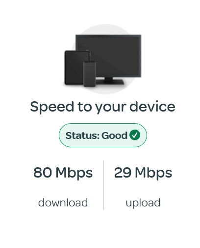

noticed a few disconections on my service over the last few days and have also noticed a massive slow down in my service which seems to fluctuates aggressively.
checked the eero app that says its at full speed but everything else showing less than 100 meg down usually around the 90 meg down mark. Upload speed is consistant at around 28/30 meg up?
ive rebooted the eeros from the app and still shows no sign of improvement ?
currently on the full fibre 150 plan
thoughts?

The eero app is showing 150 down 29 up on the iphone same with the ipad which are both conected to the bedroom eero chris. I need to ask my son to check the dongle on the laptop is working ok because seems to be the laptop giving strange readings at the moment.
i will give it today to settle back down chris and will recheck it again in the morning

Hi michelle
powered down the ONT as requested but also powered down the eeros as the one in the bedroom seems to be acting strange at the moment i.e disconecting? Also noticed that the eeros have chosen a low band to work on instead of the higher bands they normally work on so at present they are on channel 52 instead of 149/155 also my link speed between the eeros have dropped too from 860 meg to 556 not sure if the system is still settling down after this morning reboot.
i will give it another 24 hours to settle down and see what if anything improves
will say though im getting the signal from the bedroom eero and for the last few days its felt very warm even though ive only 3 devices conected?
The link speed between the eeros seems to be fluctuating really badly still getting less than meg to the laptop but when i attach the iphone to the main router via client steering it seems to run at full speed? wondering is theres an issue with the second eero?
thoughts?
