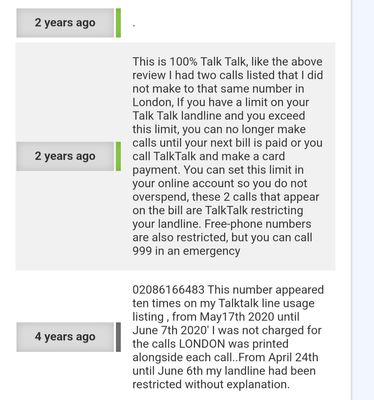

Now instead of me seeing the Trucall number dialing out each day, I now see a TalkTalk number 02086166483
When I phone this from my mobile I am greeted with a voice message saying " You have been diverted to this number by TalkTalk to reactivate your phone line"
This number only appears on my bill when Trucall box is attached, but if I remove the Trucall box I don't get that number which appears as free on my bill BTW

Ive explained what's happened here, again this is no reflection on you there is no effect on your credit rating etc its just our system does not allow us to block all outgoing calls (which you requested) without this method of barring, and the subsequent diversion.
Again, you are not in debt, never have been this is just what you requested to stop truecaller (not our system) from auto dialing out.

The calls are being redirected due to us as the bar on the line is a debt collections barr. So it appears truecall is still dialing out.

Apologies , Its the only way to place an outgoing barr, You are not in debt and never have been, it simply a system issue. When that type of barr is added it routes calls to our call center, there is no other alternative bar, that fact remains something is still dialing out from your property

@Chainsawcharlie, if you check that number, you get this on "who called me":
This suggests that it's in the nature of the bar to divert the calls to that number, to prevent you running up a debt.
As you say, you are NOT being charged.
Trucall would appear to be causing the problem. Hopefully staff can clarify further.
