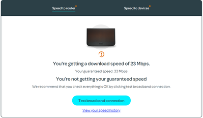

Thanks ... I understand there is an overhead when using WiFi ... but the router is reporting 45Mbps and tests show 23Mbps.
So there is a descrepancy between the router reported and measured. I am sure yours is working just fine.
The TalkTalk speedtest is working, confirming my FAST 21Mbps results (a ~2Mbps overhead for over WiFi)
@Debbie-TalkTalk ... I would have expected the training to improve the speed by now? Am I being inpatient?

Thanks nophead for the reply
It seems to be very unreliable in connecting, once refreshed, logged out etc a lot of times it displays some unbelievable data.
It only shows the 2.4GHz WiFi, although the 5GHz is enabled (I am connected via it).
It shows no WiFi connected devices, although I know they are. All seems very confused.
It also shows the DS as 45Mbps and US 6.5Mbps which I am way off.
I have reset the cache, in case it was showing cached data.
All in all, its seems to be showing incorrect and missing information
Tim

Hi Debbie
So the good news, is that the connection is no longer dropping out, which is fantastic, you only learn how much you need the internet when it is not available!
The speed is stuck at 21Mbps however, it has not improved over the last couple of days, which it has much more quickly in the past.
I am using the FAST website, the TalkTalk speed check is broken but I have always used FAST in the past, I was previously getting 38-42 Mbps on spot checks (expected on the FIBRE65 prediction before signing up).
An odd thing when logging into the router, I get the following screen, implying the WiFi and network connections are broken. I have not seen this before. They are both clearer working, for I am using it now ... not noticed this before. Just wondered if this could be a clue!?
