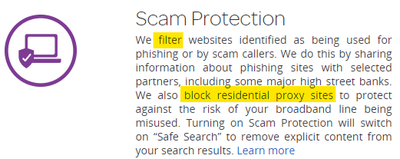

FURTHER TESTING
Broadband normal mode with Protection ON
Temporary WIRED connection for testing but cannot be used to work as router is rooms away from work area.
case 00 | Wi Fi connection       | Protection ON        | Cannot maintain VPN
case 01 | Ethernet connection   | Protection ON        | Cannot maintain VPN
Broadband temporarily switched Scam protection OFF  in "My account":
case 10 | Wi Fi connection         | Protection OFF      | connects  VPN but temperamentally, have to re-start  a couple times
case 11 |  Ethernet connection  | Protection OFF      | appear s to maintain VPN
mobile data comparison only test case:
case 100 | Mobile data   |  no TT network features   | VPN connection is maintained
jtisc
