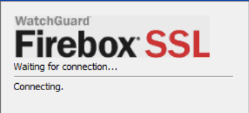

Message 15 of 25
Hi Debbie,
Thank you for updating the Firmware.
I have tried to connect to my work VPN, but I am still unable to connect. It keeps getting stuck at "Waiting for connection..." as shown below.
Many Thanks,
Seelan

on 12-06-2023 04:08 PM
Message 17 of 25
Hi Keith,
I am currently using WatchGuard Mobile VPN with SSL to connect to my work VPN.
Also, do you know where I can find the Firmware in which my Sagemcom router is running?
Many Thanks,
Seelan
