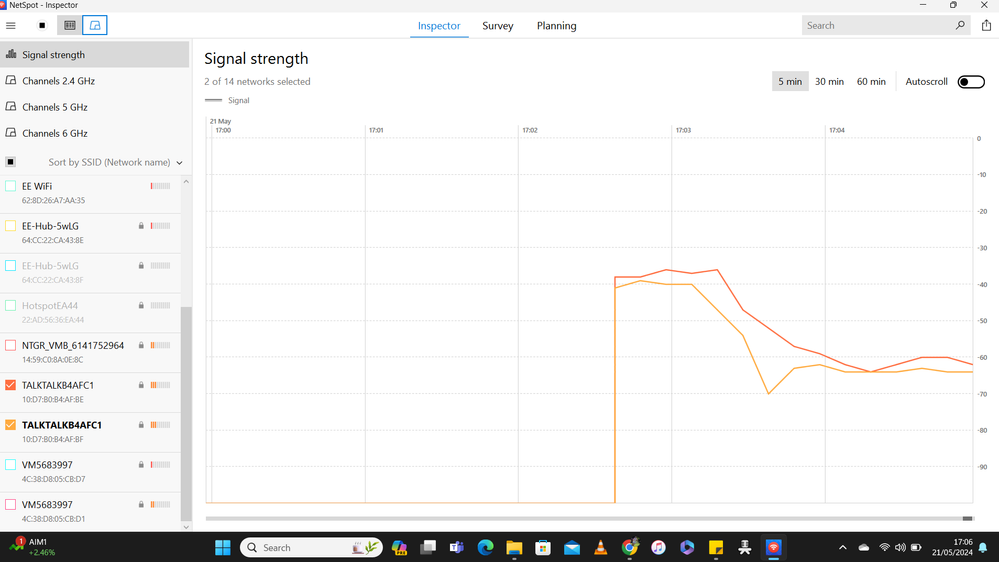

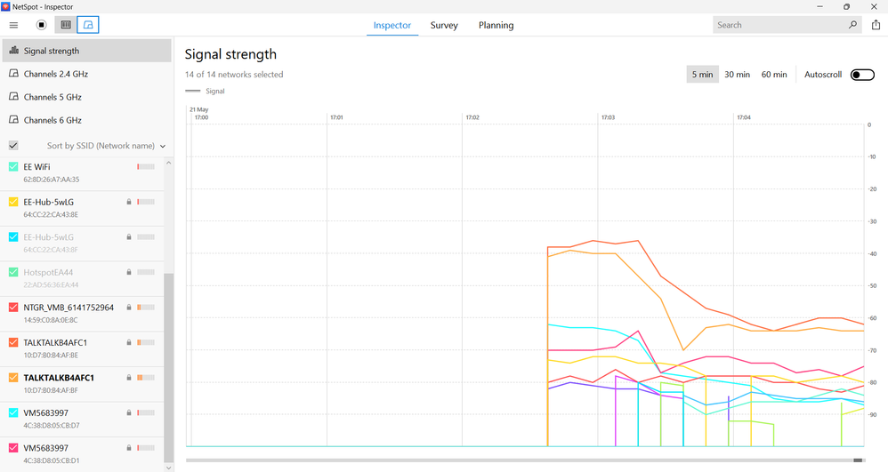

There appears to be a 2 min 30 second gap at the start of these, is there any obvious reason for this? I can't tell if there is any extra interference upstairs, as you have not included a complete set of screenshots.

Can you get me another set of traces on your laptop where the iPhones are used upstairs? Maybe the signal strength would be bad there?

Thanks for the screenshots that you PM'd me. Alas, changing channels will not solve this problem, because WiFi Optimisation which manages channel allocation will only revert them to what they were. This feature could always be disabled on the router by the TalkTalk support staff on this forum. However, they have now been told that they must not disable it anymore.
Having said that, your problem does not appear to be related to WiFi interference as such.
The only problem that I can see is that at about 11:15.45 you lost all network signals briefly. With it being all of them, this points to your PC & is probably a USB Power Management issue within Windows (I can tell you how to sort this out). Are the problematic services just running on your PC, I am guessing not. Do the problems only happen on certain WiFi bands? Where in your property is the router located & what is around this in respect of electrical equipment, large metal objects or water tanks of any description?
