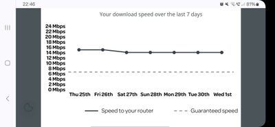

@Debbie-TalkTalk, My Connection did start recognising my devices later yesterday but I am experiencing the following continued dropouts (and inconsistent information in My Connection):
2nd May: 22.35 new phone. Very brief dropout
3rd May: 07.08 new phone, very brief then old phone permanently "connected without Internet" until I manually switch off the settings and back on for WiFi on the phone.
Strange inability of My Connection to give consistent information:
Under "connected devices" my phones are listed as "unrecognised".
Under "run a speed test" it recognises and names the devices perfectly well.
Running the speed test gave me current speeds to both phones at once despite the older one showing connected without Internet at the time.
So how can My Connection give a speed test result for a device that is not receiving the Internet at the time?
Speeds are slightly lower since you adjusted something last Friday.
NOW ANOTHER BRIEF DROPOUT WHILE TYPING THIS ON THE NEW PHONE, 7.40am. Old phone perfectly OK.
There are no smart gadgets in the house other than these two phones and even Fast Broadband should manage that, particularly when one or other phone is simply "on" but not being actively used by me at the time.
This has been happening now for about a month. I was using both phones already for c 5 weeks before this started, without noticeable problems.
One thing that you have not checked is wifi optimisation. Could this be switched off in case there is interference from neighbours' gadgets?
Not pleased, therefore, with the new router being no better than the old regarding the dropouts so far.
