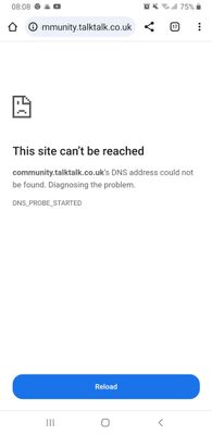

And yet again, both phones simultaneously:
The new phone:
Notice it shows the WiFi disconnection symbol top right.
Old phone:
 Notice that the wifi actually looked like it was OK but the old phone showed me this message.
It's becoming a nuisance....must try to get on with other things today!

Am back home again, and this evening (Sunday) I was right beside the router when the internet dropped with the current Sagemcom.
So it means it's happening PM as well as morning.
The light on the router remained white.
I got the "connected without Internet" message under my settings.
But the page that I couldn't reach at the time gave me the error message:
No Internet
Try ..... etc
DNS_PROBE_FINISHED_NO_INTERNET, 28th April.
It remained off until I switched off WiFi in settings and reconnected when I clicked it on again.
Annoying that it's the sort of error that you don't appear to see at your end, as the internet is effectively unusable at these times, from the customer's point of view!
Google searches do seem to blame the router in these situations, so it must have suffered some damage in the lightning strike.
